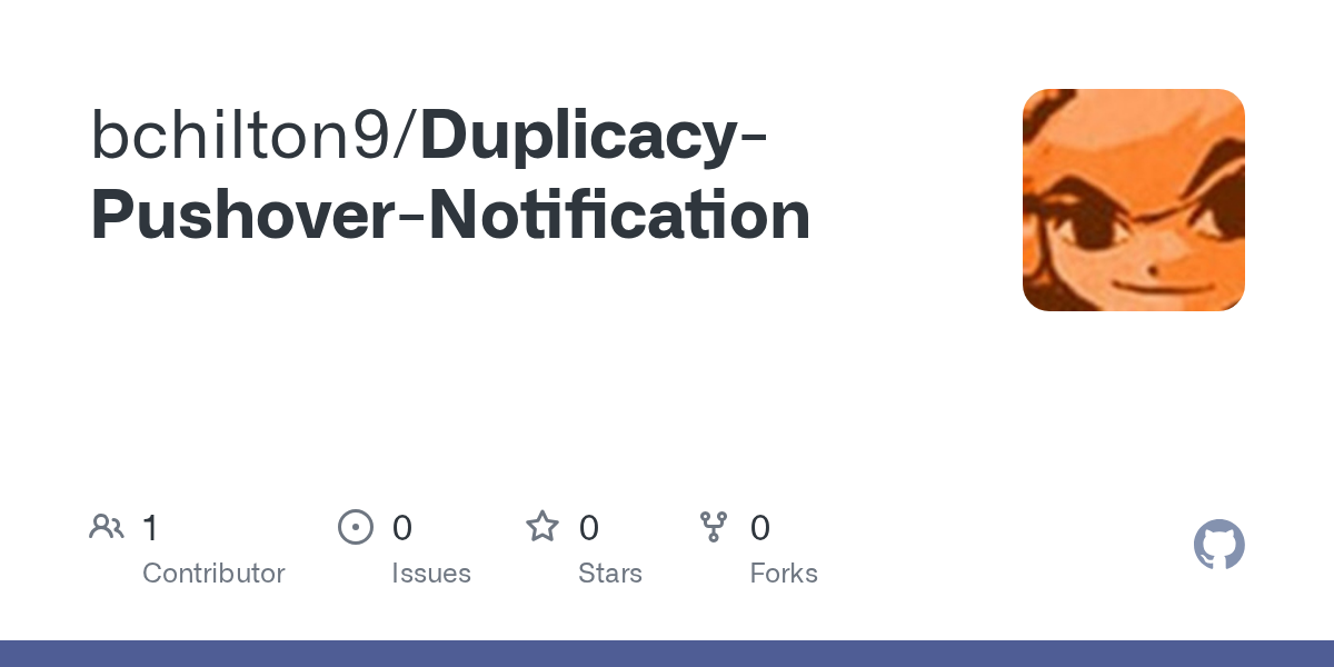

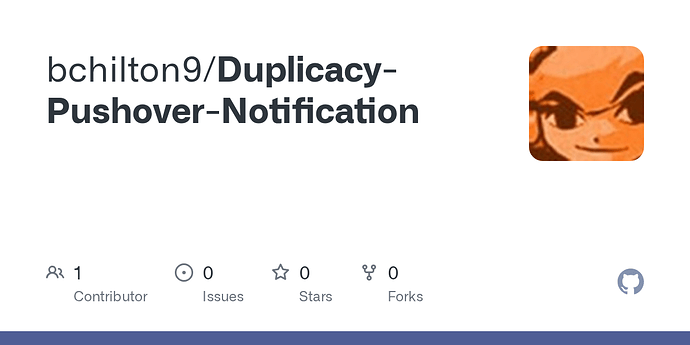

Another potential approach, which I mentioned here, is this Duplicacy-to-Pushover webhook to allow Duplicacy to use the Pushover API:
I’ve played around with it a bit, and so far it appears to work fine.
Note that this is not a true monitoring solution, in that it will not notify you when Duplicacy is down, or if a scheduled job never executes. It uses the information in the Duplicacy backup reports to craft Pushover alert messages. It appears easy to modify the php script to provide different notification content, or to only send notifications based on specific conditions (e.g., backup failure, if you’ve elected to receive error reports).
This is something I stumbled upon while researching notification tools; I have no affiliation with this, and all credit belongs to bchilton9.
