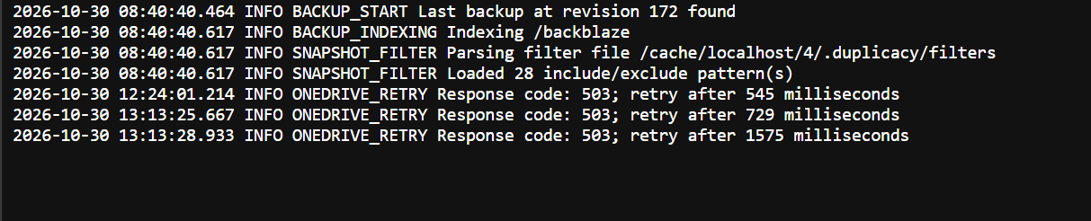

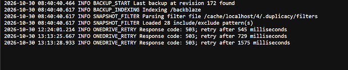

I’m using OneDrive Business. I’m trying to backup up about 400GB of a new folder. I use 1 thread. I plan on stopping the upload again and selecting less files to upload in one go.
I don’t know how to update my comment but it still happening. I still only use 1 thread and i’m trying to upload about 300GB this time. If i exclude folders and upload smaller portions it works without error.
