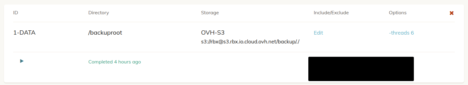

I just set up a backup via the web user interface and everything went well.
Except that Duplicacy can’t find any backups on the S3 bucket and tells me in the logs:

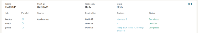

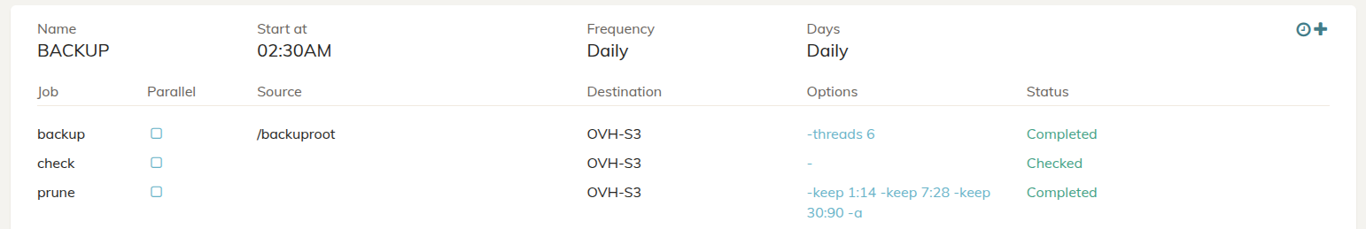

Here is my schedule :
