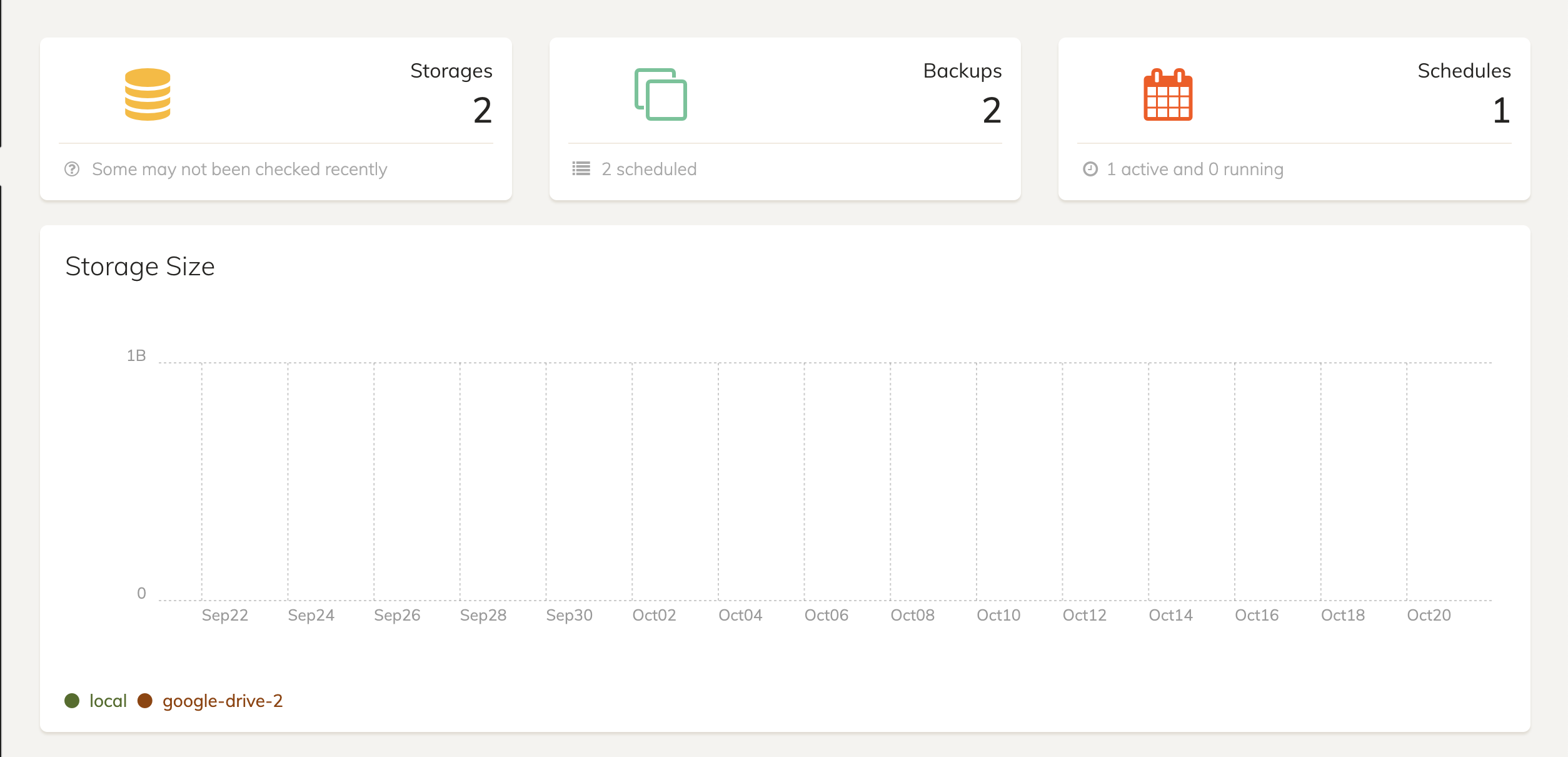

Cannot see stats in dashboard in web version
Hey!
Basically I am running duplicacy using docker with this image: image: Package duplicacy · GitHub
Some time ago I noticed that I was no longer seeing stats in the dashboard:
I checked my logs and I did not see anything wrong here.

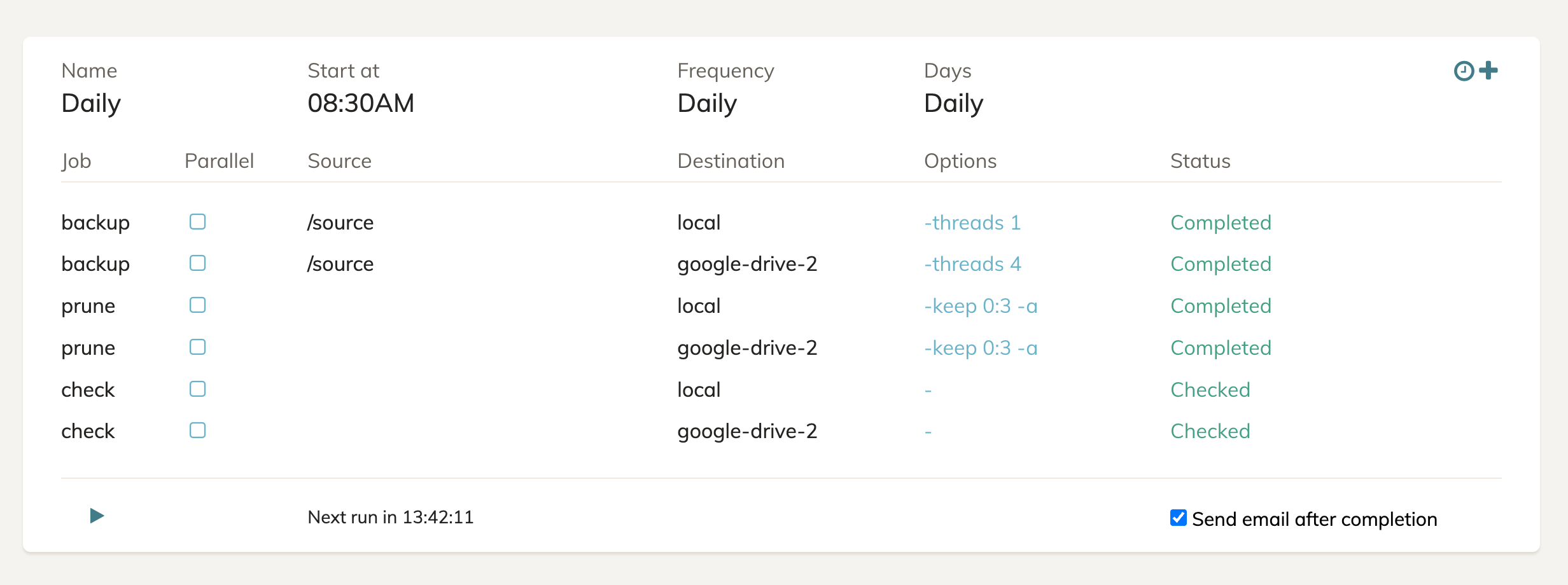

Is “check” scheduled to run periodically?
Yes! I have a schedule routine that after back up it does the check

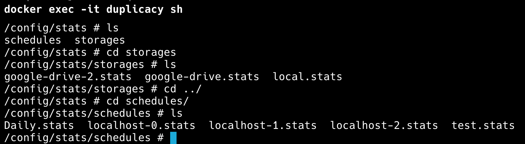

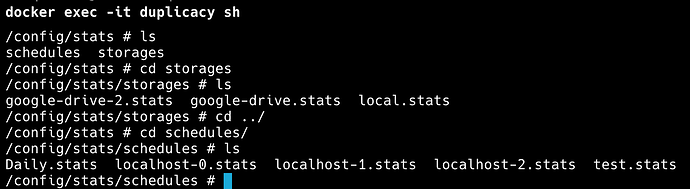

I see a stats folder under that location and I believe it is writable, here is what I did:
/config # cd stats
/config/stats # ls -ld .
drwx------ 4 hotio hotio 4096 Dec 31  2023 .
/config/stats # touch testfile && echo "ok" > testfile && cat testfile && rm testfile
ok
/config/stats #
Also, these are the stats files:
