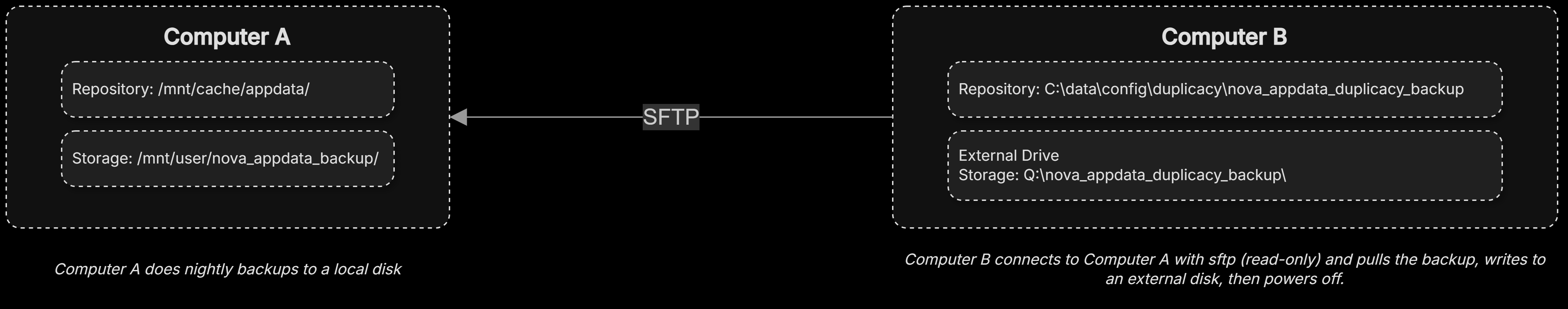

am going to assume I failed explain coherently so I am going to try again, sorry.
Basically I am trying to mitigate the risk of a ransomware attack by pulling a Duplicacy backup to a second computer with an external drive over sftp.
Here is the gist
  1. Computer A does nightly backups with Duplicacy and stores the backups on a local disk. Computer A has an SFTP server.
  2. Computer B connects to A and pulls the backup, and stores the data on an external disk, then powers off.
What I don’t understand is how to actually technically do this in Duplicacy.
I really hope someone can help as I have just bought a second computer primarily for this task.:pray:

The first thing I did on Computer B was:
I cd into the repository folder where I want the .duplicacy file (not the actual data). In this case:
cd C:\data\config\duplicacy\nova_appdata_duplicacy_backup
Then I initialize the ftp storage with:
duplicacy init -e nova_appdata_duplicacy_backup sftp://username@192.168.10.10:2022/nova_appdata_backup
it prompts for the ssh and storage password — good. Then it says:
C:\data\config\duplicacy\nova_appdata_duplicacy_backup will be backed up to sftp://username@192.168.10.10:2022/nova_appdata_backup with id nova_appdata_duplicacy_backup
Then it generates the `.duplicacy/preferences which looks like this:

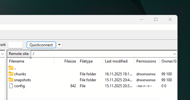

How can I make Duplicacy read from the root directory of an SFTP storage?
If I use:
        "name": "default",
        "id": "nova_appdata_duplicacy_backup",
        "repository": "",
        "storage": "sftp://username@192.168.10.10:2022/",
        "encrypted": true,
        "no_backup": false,
        "no_restore": false,
        "no_save_password": false,
        "nobackup_file": "",
        "keys": null,
        "filters": "",
        "exclude_by_attribute": false
I get:
Source storage set to sftp://username@192.168.10.10:2022/
The SFTP storage directory can't be empty
Removing the trailing forward slash doesn’t make a difference.
I have double checked that this path works in FileZilla with the same credentials so I know Duplicacy should be able to read the files without any permission issues. Here is the evidence:
Double slashes should do it:
sftp://username@192.168.10.10:2022//
Thanks. Where did you get that info?
I tried "storage": "sftp://username@192.168.10.10:2022//", but got:
runtime error: index out of range [-1].
