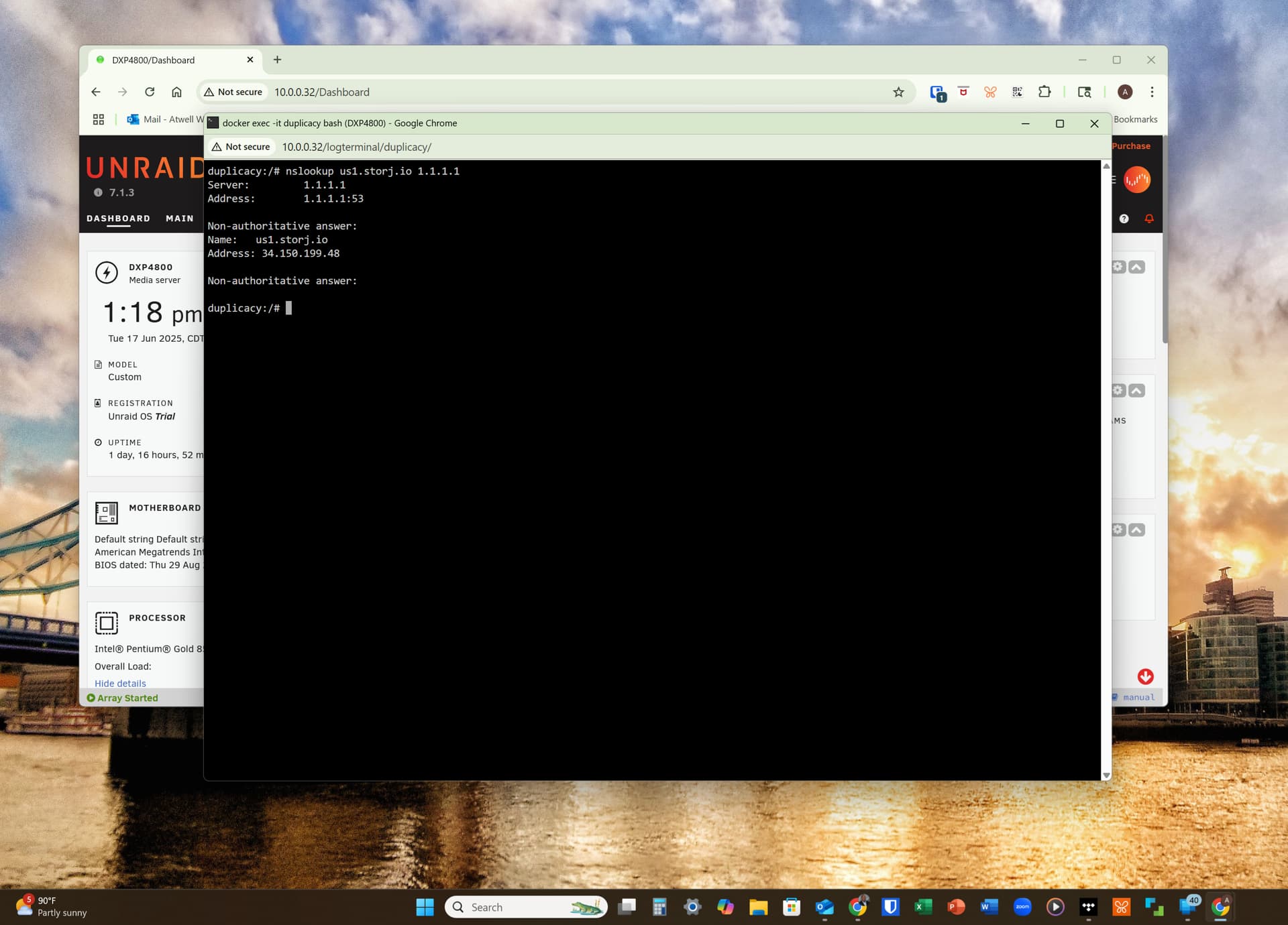

I just installed Duplicacy on my Unraid server (ver 7.1.3). I tried a small (i.e. three files < 10MB) backup and it worked fine. I then tried my full backup (1.8 TB) and it failed. The log contents is pasted below. I noticed in the log it mentioned not being able to reach us1.storj.io. I checked and can ping it just fine. Unfortunately, that’s the only information in the logs I could understand as I am brand new to Duplicacy.

2025-06-17 02:51:12.829 ERROR UPLOAD_CHUNK Failed to upload the chunk e2ac8fb9f1bf9601ae88fc42da21dc683433d54c221f2fba4c64bf949f370706: uplink: failed to upload enough pieces (needed at least 49 but got 15); piece limit exchange failed: metaclient: rpc: tcp connector failed: rpc: dial tcp: lookup us1.storj.io on 1.1.1.1:53: no such host;
