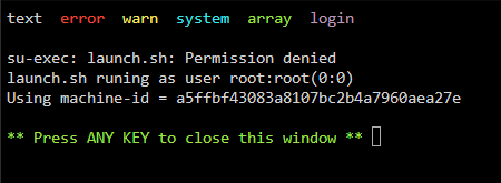

Has anyone else having issues with v1.8.3 running in docker?
Using the repository saspus/duplicacy-web:latest, which uses version v1.8.3, the container wont start. From the logs:
Screenshot 2025-10-23 095401
When rolling back to saspus/duplicacy-web:v1.8.2 it starts and runs fine. Not a massive issue as can just stay on v1.8.2 for now, but any ideas what could be causing this? Seems like permissions within the new image?
Wondering if for some reason launch.sh lost its execute flag? Let me check

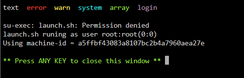

Hey, thanks for looking at this.
Pulled the latest image using: saspus/duplicacy-web:latest
But get the same error as before, logs below:
Screenshot 2025-10-24 092309-1
Rolling back to v1.8.2 using: saspus/duplicacy-web:v1.8.2
No other changes, container starts and works fine, logs below:
I tried spinning up a new container from scratch using the latest version, wouldn’t start with the same errors in logs
