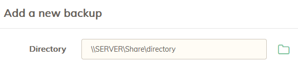

In Windows, you don’t actually need to map a drive letter to access a network share - you can use its UNC pathname in the format:
\\server\share\directory
Duplicacy GUI won’t let you browse there, but you can type or paste the complete path directly into the field (instead of clicking the folder icon):
(Forward slashes instead of backslashes may work too.) This should work - so long as the user account you’re accessing the share under also exists on the server hosting the network share, and the passwords match.
If you installed Duplicacy GUI as a service, you may have to change the user account the service runs as (right-click the service > Properties > Log On tab).
Best practice might be to create a special user account (on both sides), but then it may not have access to your Windows user profile, unless you add permissions for that user. Easiest way would be to use your normal user account, or reinstall Duplicacy in per-user mode.
