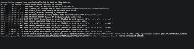

I’m having a permissions error with my backup suddenly that’s persisted about a week before I noticed, possibly more. I’m running duplicacy in docker on unraid so don’t have good cli access.
It seems like this one chunk keeps giving me permissions errors right at the end of my backup but the rest goes through. Wondering what arguments might fix it, or if I should try to find the offending chunk on my backup server and delete it?
There shouldn’t be anything that changed with any permissions so it seems odd, especially since it’s at the very end of the backup, literally the last thing it tries in the final few seconds.
edit: Actually it seems like just from today there are two or three different ones it happens with from testing, not the same one every time, but the same couple pop up a few times. Going to try with -d
Seems like literally everything runs perfectly until the very end with two chunks, I can see every new file uploading fine. Hmm. Nothing more helpful with -d -v
Pruning, checking, or anything else I can think to try doesn’t do anything at all. It seems like it’s mostly a different chunk name each and every time but I can’t even see what file it’s trying to upload that causes that.

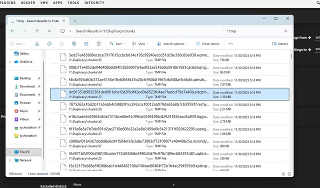

there’s nearly a thousand .tmp files that an exhaustive prune doesn’t touch. Way more errors after the prune. Going to have to figure out how to delete them since unraid permissions are annoying for duplicacy created stuff
How so? Give the user duplicacy is using full access to your folder. It seems it lacks rename access.
If you have AppArmor enabled — then this is additional layer of complexity.
Exhaustive prune won’t touch tmp files. They are not valid chunks. They are artifacts of permission issues with uploading file to e.g. SFTP remote.
Duplicacy has full access over SFTP but since the files are made by the stfp docker I had to go and redo permissions to be able to delete them.
I went through and deleted all of the .tmp files, it missed 40 so I redid it with another check and prune, same exact issues.

Please elaborate. There are two user accounts involved: one is the account that runs duplicacy in the c container – it’s irrelevant for the present issue, because if you connect via SFTP, the user you connect as is whose permission to the storage matter.
Tangentially, some SFTP remotes (Synology disk stations being most infamous ones, but there are many others) have known issues that prevent them from working correctly, even when permissions are correct; the suggested workaround is to use absolute paths in SFTP connection string (note two /), e.g:
The symptoms (intermittently disappearing files and random failures) are consistent with that.

When duplicacy is not actively backing up there shall be no tmp files. The fact that tmp files remain means “rename” fails. Why? No idea. Bad permissions, corrupted filesystem, bad SFTP server… pick any or all. This is the root of the problem.

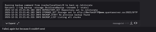

So, I did have some issues with smart errors on one drive, I decided to start my backup from scratch, however I’m still getting the same errors, and so is my buddy who is backing up from his place to my server. We both nuked our backup set and started again redoing sftp permissions and everything, I went as far as to do the whole array.
So whatever this is, is affecting both of us and it makes no sense, uhg. Haven’t tried a vpn yet but yeah, idk why it would suddenly not work with sftp.
I ran smaller backups without any issues uploading 12 gigs easily, but then the main pool, every time it does this. I don’t see why that would make a difference though, but the other two backups run flawlessly
So, running another test and need to check and confirm, but, I think SFTPgo made some sort of change or restriction in the concurrent number of connections allowed, in a shitty move to persuade people to upgrade to a paid model.
I throttled it down to 5 threads and it does now seem to be running, some parts of the log indicated that it was limited by that after running it through copilot to sift through it all.
Extraordinarily shitty move, I may not have needed to nuke my backup at all. Didn’t feel like bringing my backup server back over here, but it’s going to take nearly a month at this rate to back up, so it might be worth the minor hassle to bump that up to only a week. We’ll see if that estimate changes much over the next day or two.
