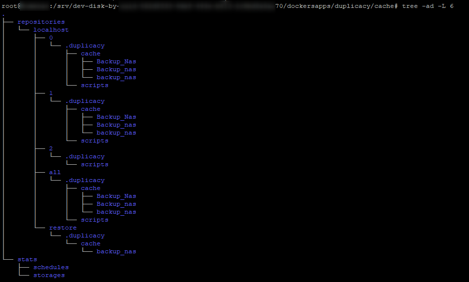

Which container? saspus’s? then /cache is what is mapped to .duplicacy_web/repositories. So you shall put your scripts to /cache/localhost/<number>/.duplicacy/scripts folder for backup, and into all subfolder for prune and other tasks.
If you use different container then refer to that container documentation or source.
References:

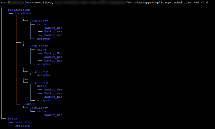

Thanks, I have tried this also, in my picture here cache is the mounted volum for cache in the docker, i have put the scrips folder everywhere as you can see btu still cannot get the script running.
What the mean ? ( in the WEB UI the backup ID are not number)
And yes I am using the Sapsus Container (thanks for this, you’r a god)
