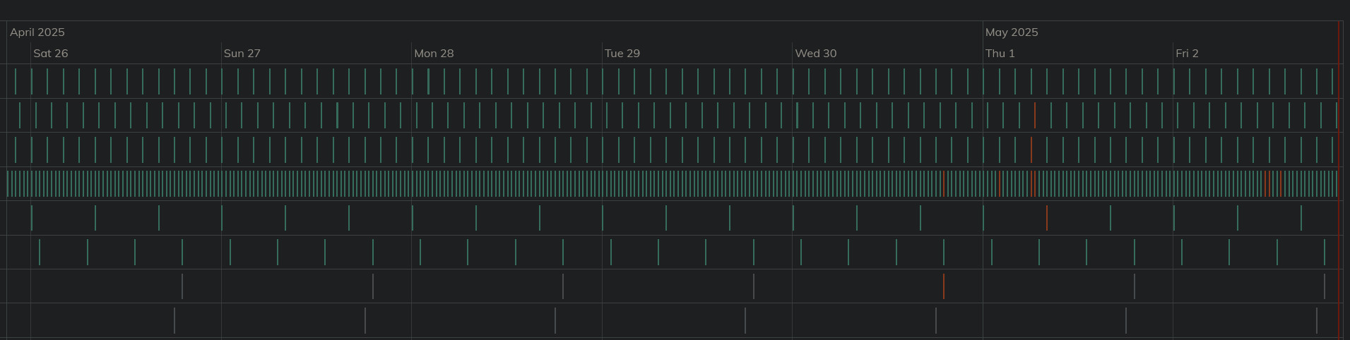

Here is the overview from this week
2025-05-02_204428|690x174
